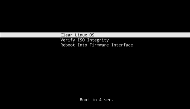

Verify integrity of installer media (optional)¶
Use Verify ISO Integrity to verify the checksum of the image burned to the installer media. The checksum ensures that the ISO is uncorrupted (see Figure 1). For every ISO generated, the clr-installer implants checksums, which are verified during early boot stage as part of initrd.
Select Verify ISO Integrity. The media will be validated.
If the check passes, it will boot into the live image. Continue in the next section.
If the check fails, a failure message appears.
Restart the process at Preliminary Steps.

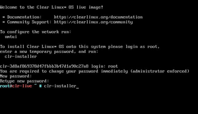

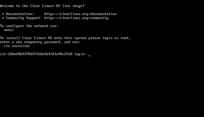

At the login prompt, enter root.
Follow the onscreen instructions, shown in Figure 2, and enter a temporary password.
Figure 2: root login¶
If a wireless connection is needed, connect to the network using nmtui before lauching the installer. See the documentation on configuring Wifi with nmtui for more details.
At the root prompt, enter clr-installer and press Enter.

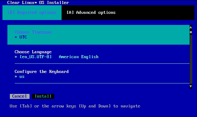

Minimum installation requirements¶
To fulfill minimum installation requirements, complete the Required options. While not required, we encourage you to apply the Recommended options. Advanced options are optional.
The Install button is only highlighted after you complete Required options.
Required options¶

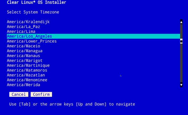

Choose Timezone¶
From the Main Menu, navigate to Choose Timezone. UTC is the default.
Select Enter.
In Select System Timezone, use Up/Down arrows navigate to the desired timezone.
Press Enter to confirm.
Figure 5: Select System Timezone¶

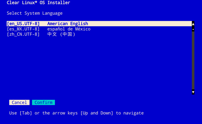

Choose Language¶
From the Main Menu, navigate to Choose Language.
Select Enter.
In Select System Language, navigate to your desired language.
Figure 6: Select System Language¶

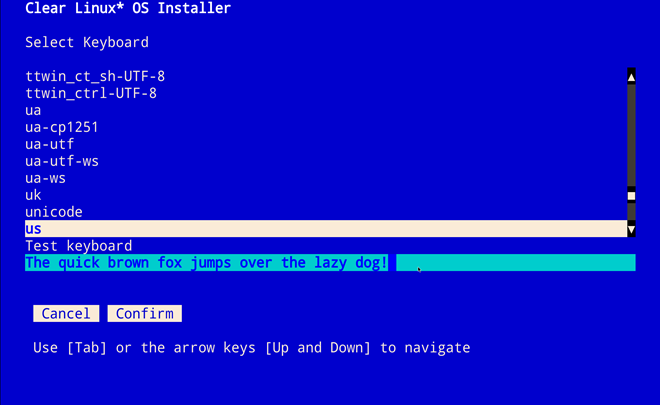

Configure the Keyboard¶
From the Main Menu, select Configure the Keyboard.
Select Enter.
In Select Keyboard, navigate to the desired option.
Select Enter to Confirm.
Optional: In Test keyboard, type text to assure that the keys map to your keyboard.
Figure 7: Select Keyboard menu¶

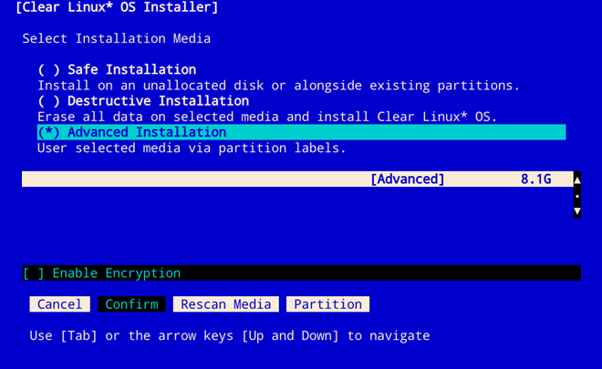

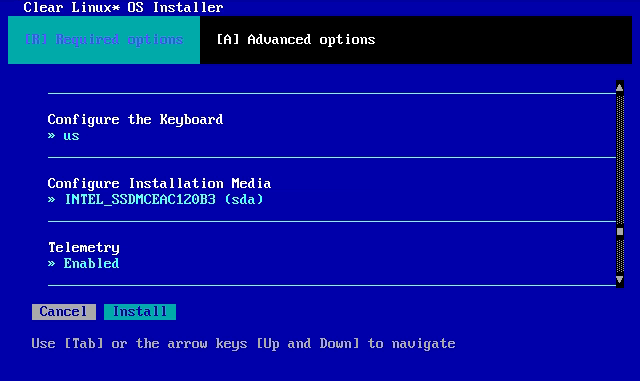

Configure Installation Media¶

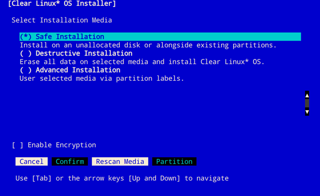

From the Main Menu, select Configure Installation Media.
Choose an installation method: * Safe Installation * Destructive Installation * Advanced Installation
Figure 8: Select Installation Media¶
Select Rescan Media to show available installation targets.
Safe Installation¶
Use this method to safely install Clear Linux OS on media with available space, or alongside existing partitions, and accept the Default partition schema. If enough free space exists, safe installation is allowed. See also Troubleshooting below.
Destructive Installation¶
Use this method to destroy the contents of the target device, install Clear Linux OS on it, and accept the Default partition schema.

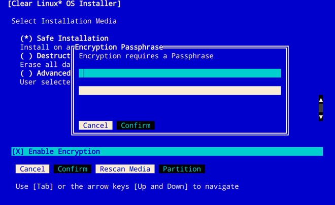

From the Select Installation Media menu, select Enable Encryption to encrypt the root filesystem for either option above. See also Disk encryption for more information.
Advanced Installation¶
Use this method to manually configure partitions using cgdisk.
This example uses the Default partition schema. The space you allocate for
your root
, or additional partitions, may vary.
Navigate to Advanced Installation and press Spacebar.
Figure 9: Advanced installation¶
If no target media appears, select Rescan Media.

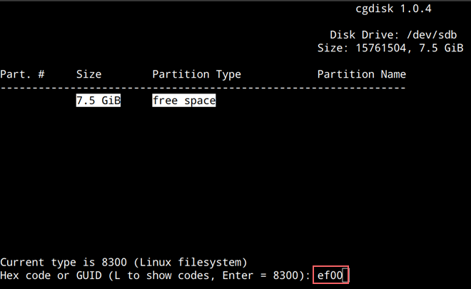

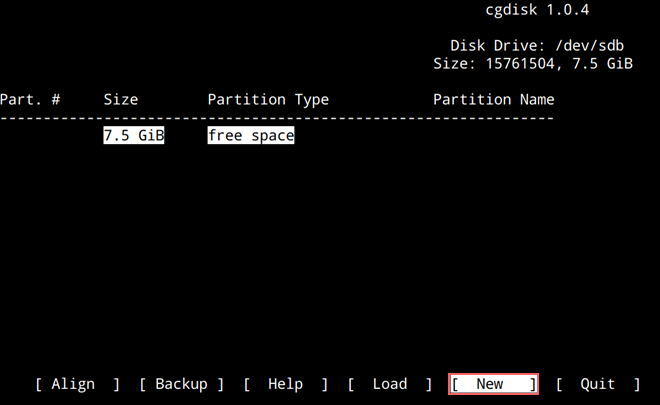

Navigate to Partition and and press Spacebar to launch cgdisk.
Partition codes¶
ef00 - EFI System
8200 - Linux swap
8300 - Linux filesystem

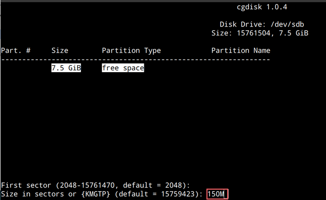

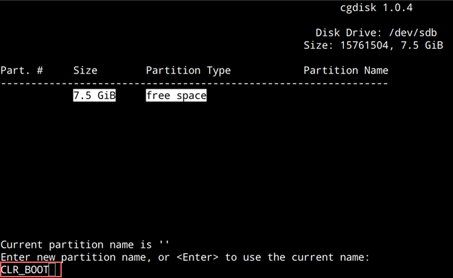

boot partition¶
With the free space highlighted in the cgdisk utility, select [New].
Figure 10: Select New¶
The /boot partition must be VFAT(FAT32).
Where First sector appears, press Enter.
For Size in sectors, type 150M.
Figure 11: Size in sectors¶
Press Enter.
Enter the hex code ef00 and press Enter.
Figure 12: ef00 partition code¶
For the partition name, enter CLR_BOOT, the EFI boot partition.
Figure 13: CLR_BOOT¶
Encryption is not allowed on the CLR_BOOT partition.

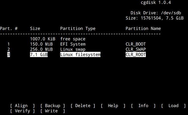

root partition¶
Use the Up/Down arrow to select free space.
Select [New] at bottom and press Enter.
Under First sector, press Enter.
For Size in sectors, type in desired size. Optionally, press Enter to use the remaining space available.
Press Enter.
Enter the hex code 8300 and press Enter.
In Enter new partition name…, type: CLR_ROOT. The /root partition must be ext[234], XFS, or f2fs. If no filesystem exists, the installer will default to VFAT(FAT32) for /boot, and ext4 for all others.
You may also append _F to the partition name to force the formatting.
- CLR_ROOT_F: Force the formatting of the root partition prior to
use.
- CLR_F_SWAP: Force the formatting of the swap partition prior to
use; helpful when re-using a partition for swap which was previously formatted for a file system.
- CLR_F_MNT_/data: Force the formatting of the extra data
partition prior to use
Press Enter.
After all partitions are defined, verify that your partition configuration is similar to Figure 14.
Figure 14: Final partition configuration¶

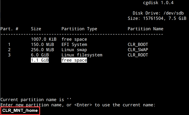

Additional partitions (optional)¶
Now select [New] at bottom and press Enter.
If you do not specify a size, it will use the remaining space.
Press Enter.
Enter the hex code 8300. Then press Enter.
In Enter new partition name…, type: CLR_MNT_<mount_point>. For example, replace <mount_point> with /home, shown in Figure 15.
Figure 15: CLR_MNT¶
If formatting is desired, the _F must precede _MNT.
Alternatively, you may create CLR_MNT_/srv or other partitions.

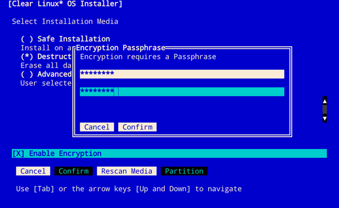

Disk encryption¶
For greater security, disk encryption is supported using LUKS for the any partition except /boot on Clear Linux OS. To encrypt the root partition, see the example below. Encryption is optional.
Encryption Passphrase¶
Clear Linux OS uses a single passphrase for encrypted partitions. Additional keys may
be configured post-installation using the cryptsetup
tool.
Optional: Select [X] Enable encryption to encrypt the root partition, as shown in Figure 16.
Figure 16: Encrypt partition¶
The Encryption Passphrase dialog appears.
Minimum length is 8 characters. Maximum length is 94 characters.
Figure 17: Encryption Passphrase¶
Enter the same passphrase in the first and second field.
Navigate to Confirm and press Enter.
Confirm is only highlighted if passphrases match.

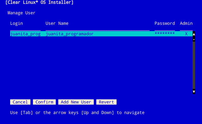

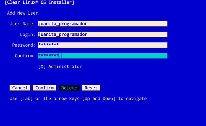

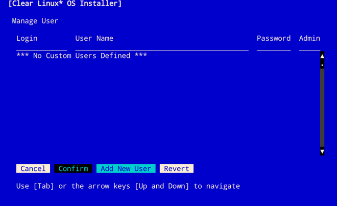

Manage User¶
Add New User¶
In Required Options, select Manage User.
Select Add New User as shown in Figure 18.
Figure 18: Add New User¶
Optional: Enter a User Name.
Figure 19: User Name¶
Enter a Login.
The User Login must be alphanumeric and can include hyphens and underscores. Maximum length is 31 characters.
Enter a Password.
In Confirm, enter the same password.
The Administrator checkbox is selected by default.
Selecting Administrator enables sudo privileges for the user. For the installation to proceed, at least one user must be assigned as an Administrator.
Select Confirm. To reset the form, select Reset.
In Manage User, navigate to Confirm.
With Confirm highlighted, select Enter.

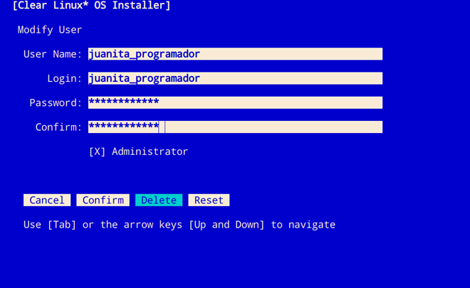

Modify / Delete User¶
In Manage User, navigate to the user you wish to modify until highlighted, as shown in Figure 20.
Select Enter to modify the user.
Figure 20: Modify User¶
Modify user details as desired.
Navigate to Confirm until highlighted.
Optional: Select Reset to rest the form.
Select Confirm to save the changes you made.
Optional: In Modify User, to delete the user, navigate to the Delete button and select Enter.
Figure 21: Delete User¶
You are returned to Manage User.
Select Enter to complete Manage User options.

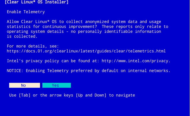

Telemetry¶
Telemetrics is a Clear Linux OS feature that reports failures and crashes to the Clear Linux OS development team for improvements.
Select your desired option on whether to participate in telemetry.
In the Main Menu, navigate to Telemetry and select Enter.
Select Tab to highlight your choice.
Select Enter to confirm.
Figure 22: Enable Telemetry¶

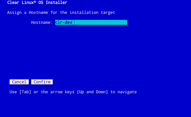

Assign Hostname Simplify your development environment

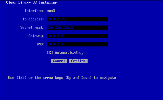

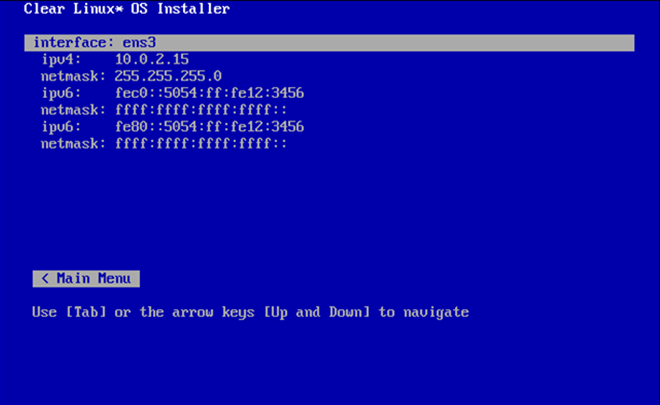

Configure Network Interfaces¶
By default, Clear Linux OS is configured to automatically detect the host network interface using DHCP. However, if you want to use a static IP address or if you do not have a DHCP server on your network, follow these instructions to manually configure the network interface. Otherwise, default network interface settings are automatically applied.
If DHCP is available, no user selection may be required.
Navigate to Configure Network Interfaces and select Enter.
Navigate to the network interface you wish to change.
When the desired interface is highlighted, select Enter to edit.
Multiple network interfaces may appear.
Figure 23: Configure Network Interfaces¶
Notice Automatic / dhcp is selected by default (at bottom).
Optional: Navigate to the checkbox Automatic / dhcp and select Spacebar to deselect.
Figure 24: Network interface configuration¶
Navigate to the appropriate fields and assign the desired network configuration.
To save settings, navigate to Confirm and select Enter.
To revert to previous settings, navigate to the Cancel and select Enter.

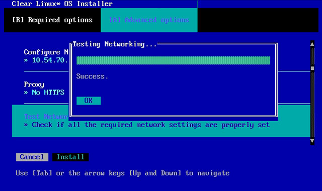

Upon confirming network configuration, the Testing Networking dialog appears. Assure the result shows success. If a failure occurs, your changes will not be saved.
Upon confirmation, you are returned to Network interface settings.
Navigate to and select Main Menu.

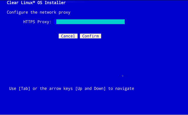

Proxy¶
Clear Linux OS automatically attempts to detect proxy settings, as described in Autoproxy. If you need to manually assign proxy settings, follow this instruction.
From the Advanced options menu, navigate to Proxy, and select Enter.
Navigate to the field HTTPS Proxy.
Figure 25: Configure the network proxy¶
Enter the desired proxy address and port using conventional syntax, such as: http://address:port.
Navigate to Confirm and select Enter.
To revert to previous settings, navigate to Cancel and select Cancel.
Optional: Skip to Finish installation.
Test Network Settings¶
To manually assure network connectivity before installing Clear Linux OS, select Test Network Settings and select Enter.
If using the off-line installer, this option is not available.
A progress bar appears as shown in Figure 26.
Figure 26: Testing Networking dialog¶
Any changes made to network settings are automatically tested during configuration.

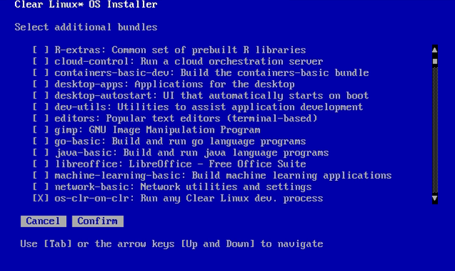

Select Additional Bundles¶
This option is only available with a valid network connection. Bundle selection is disabled if no network connection exists.
On the Advanced menu, select Select Additional Bundles.
Navigate to the desired bundle using Tab or Up/Down arrows.
Select Spacebar to select the checkbox for each desired bundle.
Figure 27: Bundle Selection¶
Optional: To start developing with Clear Linux OS, we recommend adding
os-clr-on-clr
.Navigate to and select Confirm.
You are returned to the Advanced options menu.
Assign Hostname¶
In Advanced Options, select Assign Hostname.
In Hostname, enter the hostname only (excluding the domain).
Hostname does not allow empty spaces. Hostname must start with an alphanumeric character but may also contain hyphens. Maximum length of 63 characters.
Figure 28: Assign Hostname¶
Select Confirm.

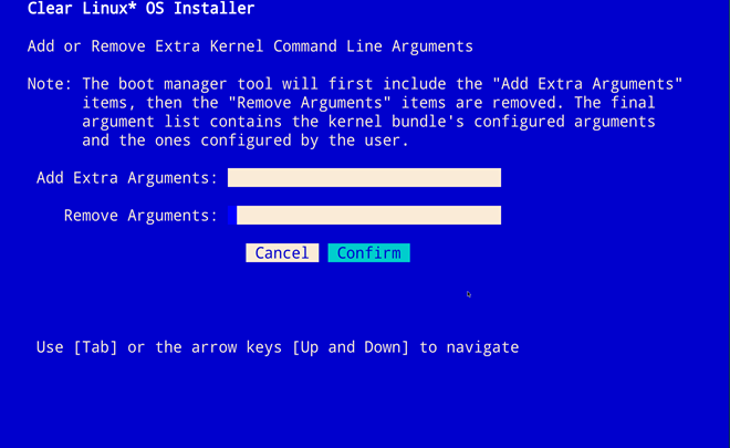

Kernel Command Line¶
For advanced users, Clear Linux OS provides the ability to add or remove kernel arguments. If you want to append a new argument, enter the argument here. This argument will be used every time you install or update a new kernel.
In Advanced Options, select Tab to highlight Kernel Command Line.
Select Enter.
Figure 29: Kernel Command Line¶
Choose from the following options.
To add arguments, enter the argument in Add Extra Arguments.
To remove an argument, enter the argument in Remove Arguments.
Select Confirm.

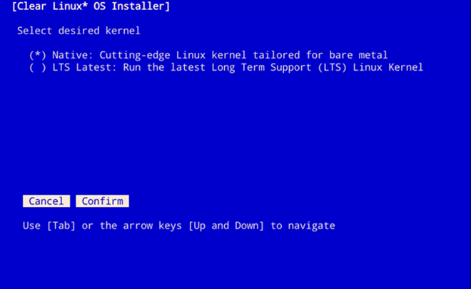

Kernel Selection¶
Select a kernel option. By default, the latest kernel release is selected. Native kernel is shown in Figure 30.
To select a different kernel, navigate to it using Tab.
Figure 30 Kernel selection¶
Select Spacebar to select the desired option.

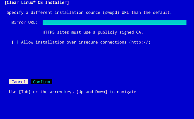

Swupd Mirror¶
If you have your own custom mirror of Clear Linux OS, you can add its URL.
In Advanced Options, select Swupd Mirror.
To add a local swupd mirror, enter a valid URL in Mirror URL:
Select Confirm.
Figure 31: Swupd Mirror¶

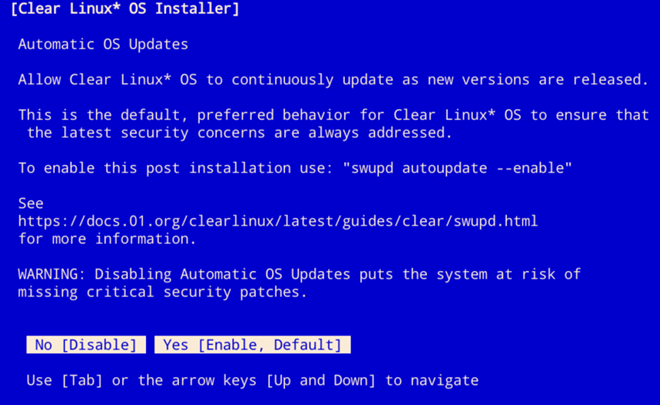

Automatic OS Updates¶
Automatic OS updates are enabled by default. In the rare case that you need to disable automatic software updates, follow the onscreen instructions, shown in Figure 32.
In Advanced Options, select Automatic OS Updates.
Select the desired option.
Figure 32: Automatic OS Updates¶
You are returned to the Main Menu.

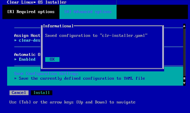

Save Configuration Settings¶
In Advanced Options, select Save Configuration Settings.
A dialog box shows the installation configuration was saved to
clr-installer.yaml
Figure 33: Save configuration to YAML file¶
Use the
clr-installer.yaml
file to install Clear Linux OS, with the same configuration, on multiple targets.
