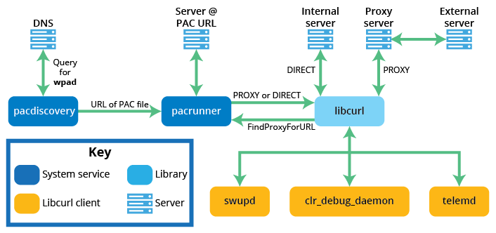

We designed Autoproxy around tools provided by most Linux* distributions with a few minor additions and modifications. We leveraged the DHCP and network information obtained from systemd and created a PAC-discovery daemon. The daemon uses the information to resolve a URL for a PAC file. The daemon then passes the URL into PACrunner*. PACrunner downloads the PAC file and uses the newly implemented Duktape* engine to parse it.
Figure 1: Autoproxy Flow¶
From that point on, any cURL* or network requests query PACrunner for the correct proxy to use. We modified the cURL library to communicate with PACrunner over DBus. However, cURL will ignore PACrunner and run normally if no PAC file is loaded or if you manually set any proxies. Thus, your environment settings are respected and no time is wasted trying to resolve a proxy. All these steps happen in the background with no user interaction.
