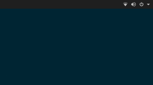

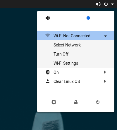

Click anywhere on the icons at the right side of the top of the screen to bring up a menu and click on Wi-Fi Not Connected then choose Select Network.

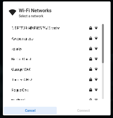

Scroll through the list and select the network you’d like to connect to and click Connect.

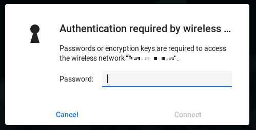

Enter the password and click Connect.
The Wi-Fi icon should now show the signal strength of the connection.

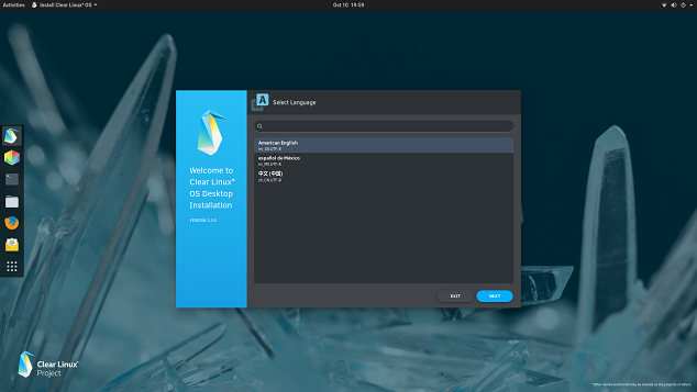

If you are installing using the live image, resume the installation process now. Your Wi-Fi configuration will automatically be included in the install.

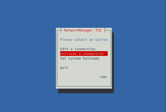

TUI (Text-based User Interface)¶
Launch the NetworkManager Text User Interface
nmtui

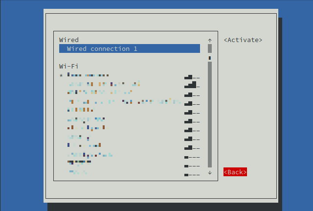

Select Activate a connection and hit return.

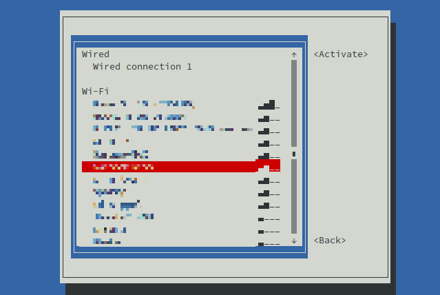

Use the arrow keys to select your network and then select Activate and hit return.

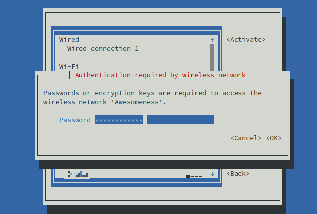

Enter your password and hit return to select OK.

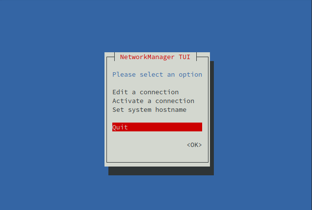

Select Back and hit return.
Select Quit and hit return to exit.
