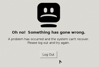

“Oh no! Something has gone wrong” GNOME* crash¶
NVIDIA driver GNOME crash dialogue on Clear Linux OS.¶
There have been reports of GNOME crashing with an “Oh no! Something has gone wrong” error message with NVIDIA drivers installed while other graphics devices are enabled.
Try disabling other graphics devices, including integrated graphics, in your system’s EFI/BIOS.
