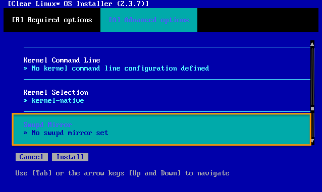

In the Advanced options tab of the installer, select Swupd Mirror. See Figure 1.
Figure 1: Advanced options > Swupd Mirror¶

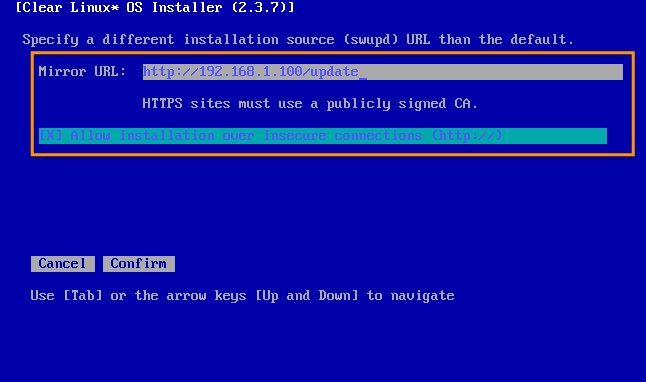

In the Mirror URL field, set it to the IP address of your mirror. It should be something like this: http://<IP address of mirror server>/update. And check the option Allow installation over insecure connections (http://). See Figure 2.
Figure 2: Advanced options > Mirror URL setting¶
