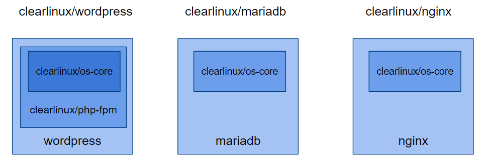

To deploy WordPress on Kubernetes, it helps to remember that containers are the fundamental components of an application. Clear Linux OS provides size-, performance-, and security-optimized containers on DockerHub. Three container images are available that include the necessary components for building out the WordPress service.
The details on how to implement Clear Linux OS containers can be found on GitHub*.

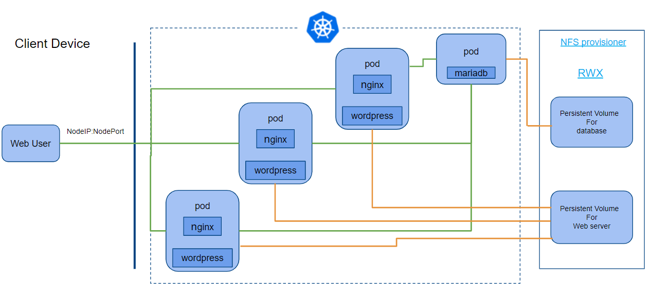

The following diagram shows a summary of the WordPress cluster on Kubernetes. Green lines indicate the interaction between pods and orange lines indicate the interaction between pod and persistent volume.
In this example, the service is exposed with NodePort and the WordPress application can be accessed in a browser by simply navigating to: http://$NodeIP:$NodePort
NodePort depends on IPtables on the Kubernetes node to randomly select a destination target pods. For details, refer to the doc: Kubernetes Services – exposing an application with NodePort.

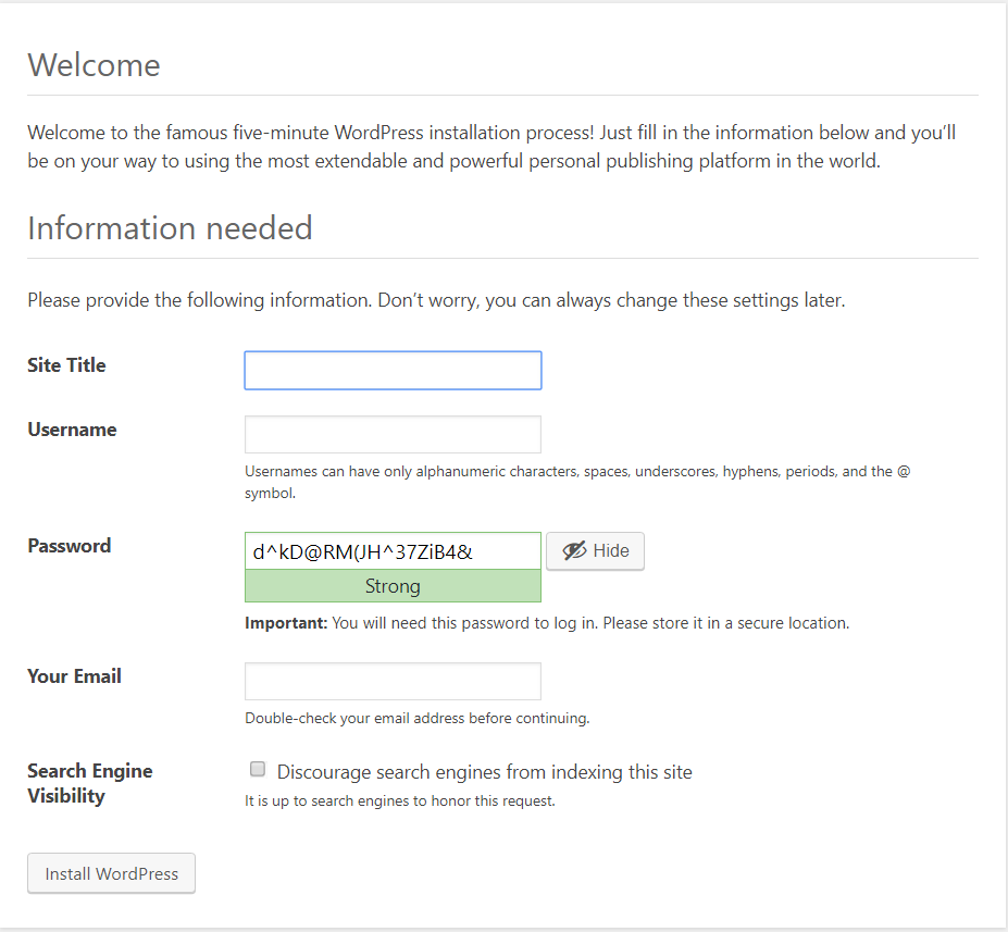

This example returned the address,
http://$(IPAddr):30180
. Open a browser and input this address. The page shown below is displayed.
- Enter the required fields to finish the setup and login again.
When complete, WordPress is ready to use and you may now write a blog.
