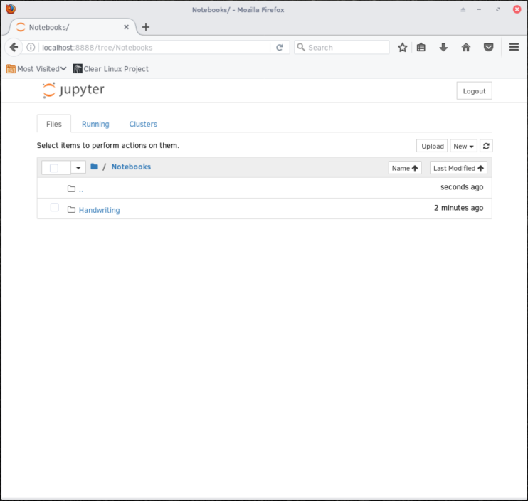

The Jupyter server starts and opens a web browser showing the Jupyter file manager with a list of files in the current directory, as shown in Figure 1.
Figure 1: The Jupyter file manager shows the list of available files.¶

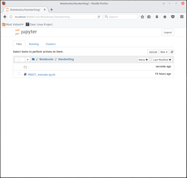

Click on the
Handwriting
directory. TheMNIST_example.ipynb
file created earlier should be listed there, as shown in Figure 2.Figure 2: The example file within the Jupyter file manager.¶

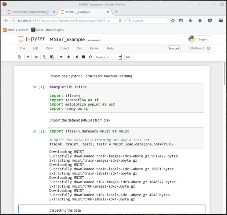

Select the In [2] cell and click the
button to load the MNIST data. The successful output is shown on Figure 4.
Figure 4: Output after successfully importing the MNIST data.¶

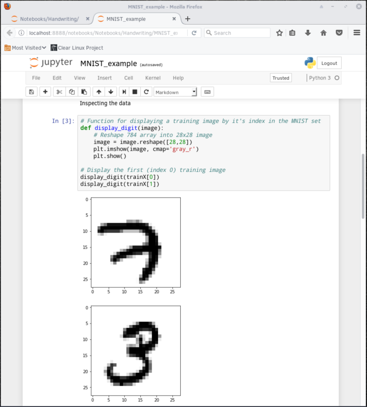

directory, four .gz files are present and the four data sets are created: trainX, trainY, testX and testY.To inspect the imported data, the function in In [3] first instructs Jupyter to reshape the data into an array of 28 x 28 images and to plot the area in a 28 x 28 grid. Click the
button twice to show the first two digits in the trainX dataset. An example is shown in Figure 5.
Figure 5: A function reshapes the data and displays the first two digits in the trainX dataset.¶

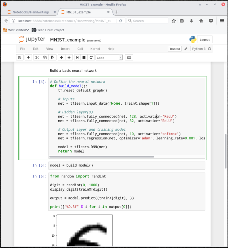

The In [4] cell defines the neural network. It provides the inputs, defines the hidden layers, runs the training model, and sets up the output layer, as shown in Figure 6. Click the
button four times to perform these operations.
Figure 6: Defining, building, and training the neural network model.¶

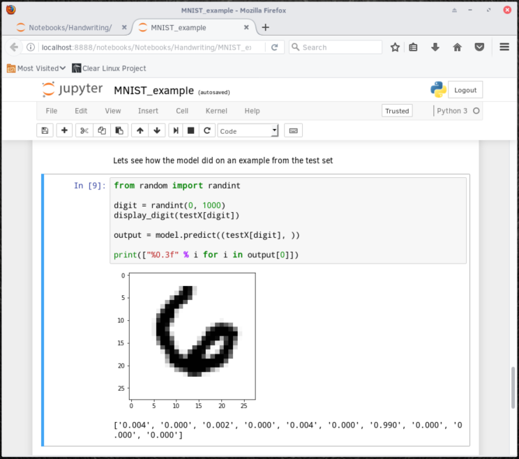

To test the accuracy of the prediction that the system makes, select the In [8] cell and click the
button. In this example, the number 6 was predicted with a 99% accuracy, as shown in Figure 7.
Figure 7: The system predicts a number providing the accuracy of the prediction.¶
To retest the accuracy of a random data point’s prediction, run the cell In [8] again. It will take another random data point and predict its value.

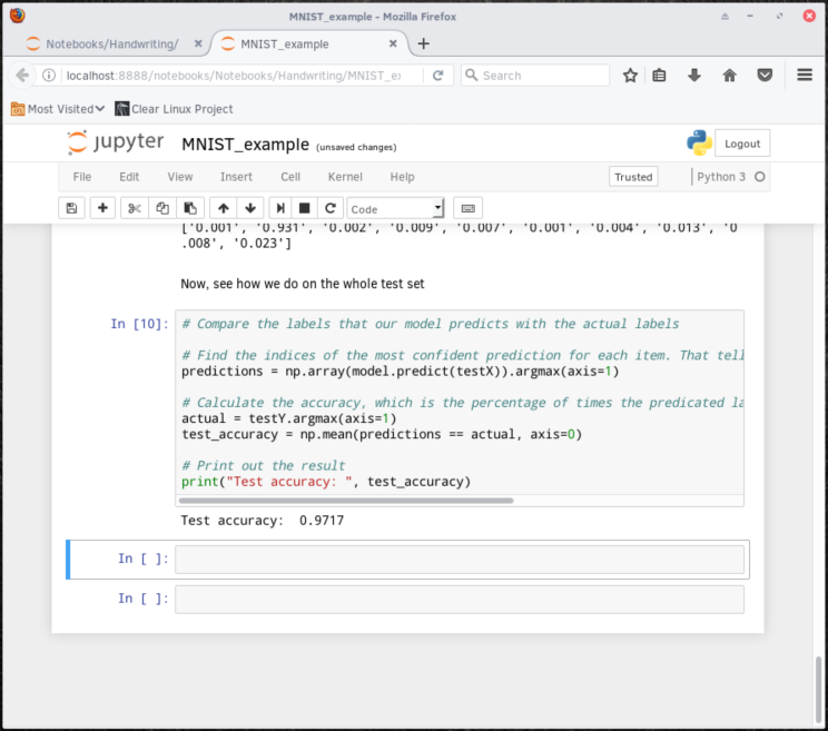

To check the accuracy for the whole dataset, select the In [10] cell and click the
button. Our example’s accuracy is calculated as 97.17%, as shown in Figure 8.
Figure 8: The system’s accuracy for the entire data set.¶
