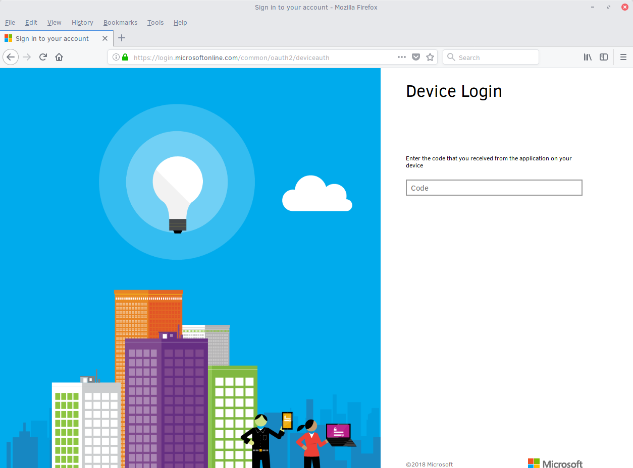

Open your browser and enter the page https://aka.ms/devicelogin as shown in figure 1:
Figure 1: Microsoft Device Login¶

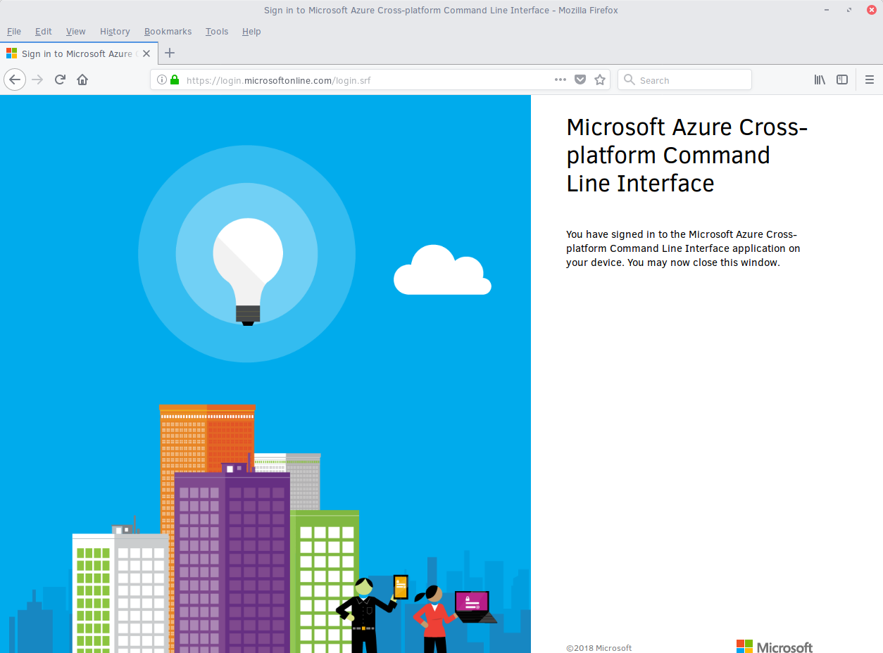

Enter the code BQ9MG442B to authenticate your device as shown in figure 2. The code BQ9MG442B is a random authentication code generated for each session login and will be different each time you log into MS Azure using the az login command.
Figure 2: Microsoft Device Login - Azure CLI¶

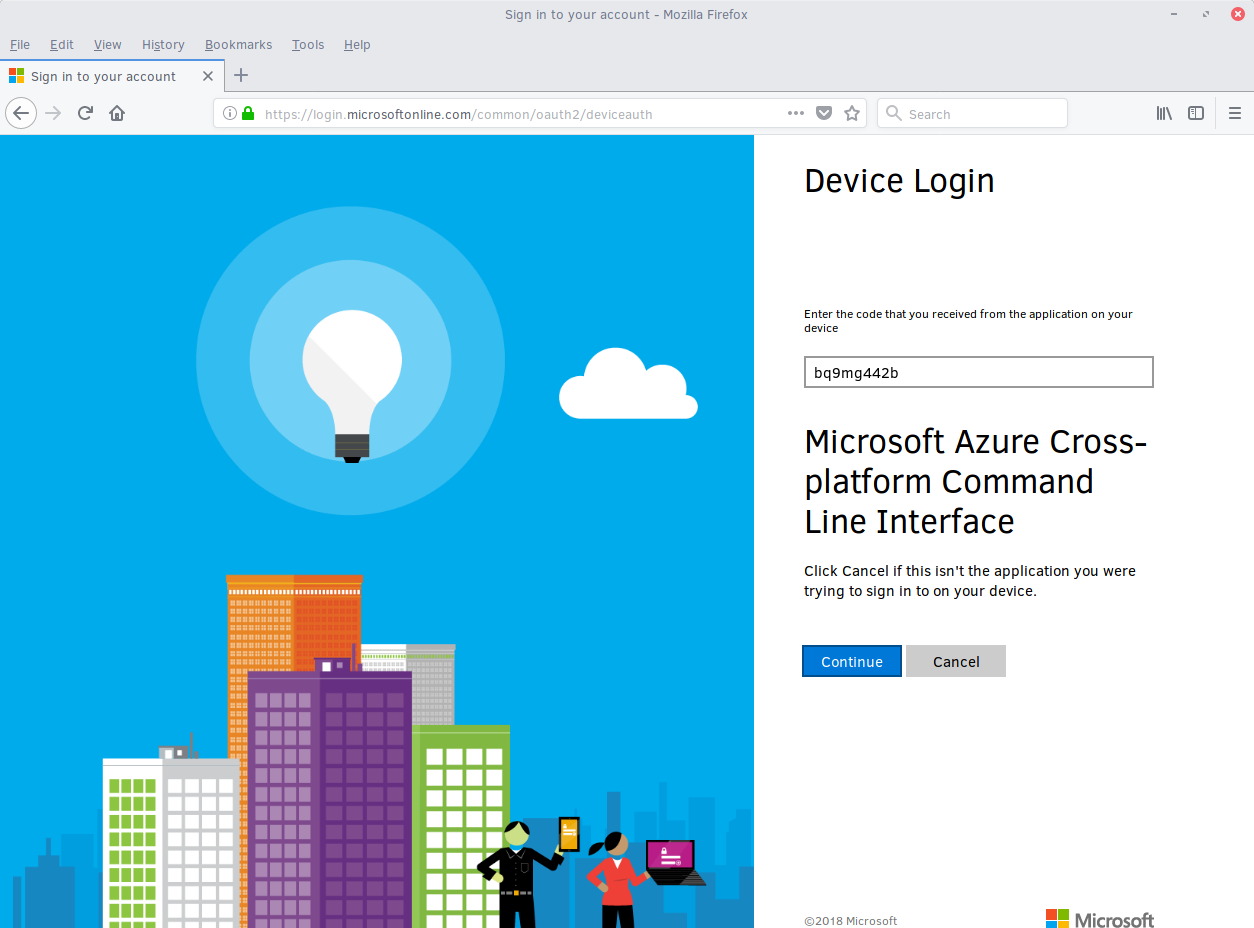

Once you enter the authentication code, the website displays a screen to enter your existing Microsoft Azure credentials.
Log in with your existing MS Azure account credentials. The browser screen shows you have signed into the Microsoft Cross-platform Command Line Interface application on your device, as shown in figure 3. You can close the page.
Figure 3: Microsoft Azure Cross-platform CLI¶
