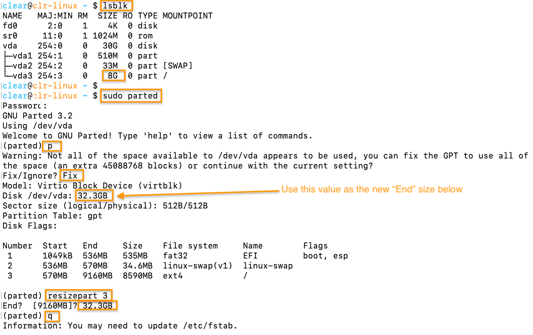

Resize the last partition of the virtual disk¶
Log in.
Open a terminal window.
Add the storage-utils bundle to install the parted and resize2fs tools.
sudo swupd bundle-add storage-utils
Launch the parted tool.
sudo partedIn the parted tool, perform these steps:
Press p to print the partitions table.
If the warning message below is displayed, enter Fix.
Warning: Not all of the space available to :file:`/dev/sda` appears to be used, you can fix the GPT to use all of the space (an extra ... blocks) or continue with the current setting? Fix/Ignore?
Enter resizepart <partition number> where <partition number> is the number of the partition to modify.
Enter the new End size.
If you want a partition to take up the remaining disk space, then enter the total size of the disk. When you print the partitions table with the p command, the total disk size is shown after the Disk label.
An example of this can be seen in Figure 1.
Enter q to exit parted when you are finished resizing the partition.
Figure 1 depicts the described steps to resize the partition of the virtual disk from 8.5 GB to 30 GB.
Figure 1: Increase root partition size¶

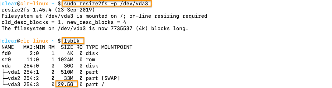

Resize the filesystem¶
Enter sudo resize2fs -p /dev/<modified partition name> where <modified partition name> is the partition that was changed in the parted tool.
Run lsblk to verify that the filesystem size has increased.
Figure 2 depicts the described steps to resize the filesystem of the virtual disk from 8.5 GB to 30 GB.
Figure 2: Increase root filesystem with resize2fs¶
